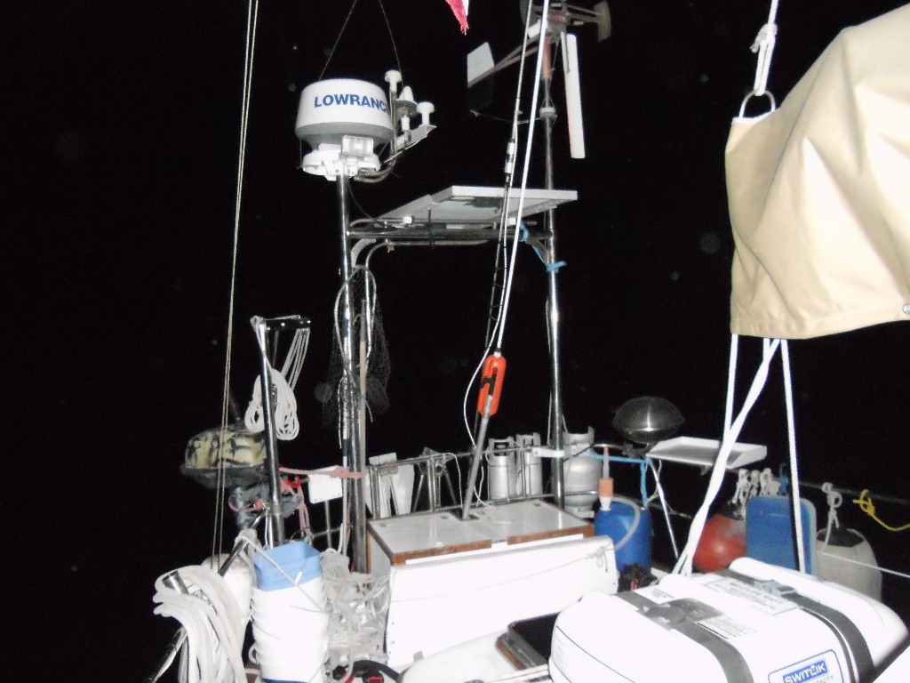

Prior to our last cruise (SF to Baja then the S. Pacific and back to SF), we bought the Nuvair compressor. A photo is shown below (except we got the stainless steel frame option). It was then used extensively during the 2 years we were out.
The compressor is small enough that it fit into the storage box that you can see on our aft deck
Stored there, it takes only a minute to open the lids, pull the compressor out, close the lids and finally, set the compressor on the closed lids of the storage box and it's ready to go. It's not exactly light, but light enough that I can lift it in and out of the box unassisted. Being so easy to access, we didn't hesitate to use it. A LOT!! At one point while we were stopped in Mopelia, it was filling the tanks for half a dozen divers. most of them doing 2 dives a day. Had it been stored in a deep hold where it was a real pain to get out or put away, it just wouldn't have gotten any use. As it was, we didn't hesitate to use the tanks.
