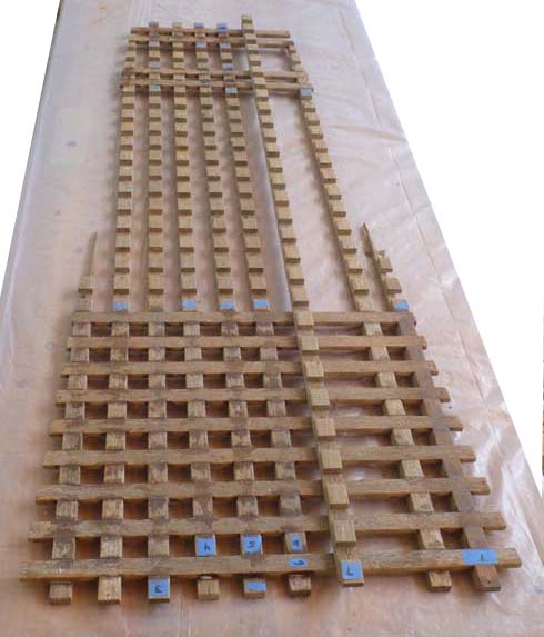

I disassembled the grate into its component pieces and removed the brads and as much of the resorcinol glue as I could.

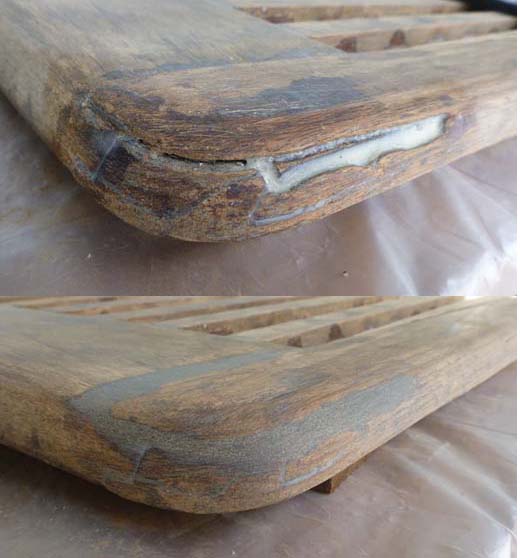

Mortise and tenon joints were used at the corners of the frame. The mortises were very deep, leaving only about 1/8" of wood which, over time, had broken out and left voids on three of the corners that needed to be filled.

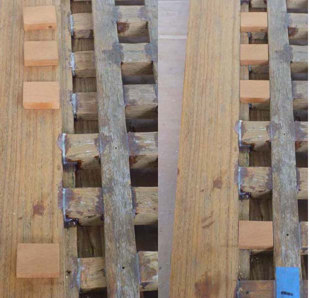

On five of the longitudinal strips, the upper part of the forward ends had broken off and needed to be replaced.

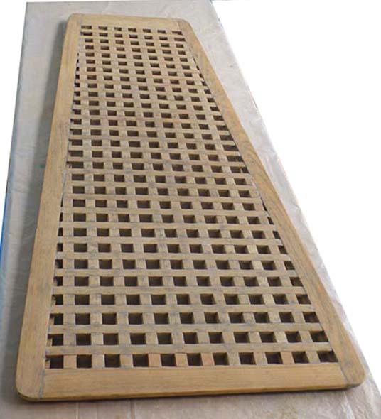

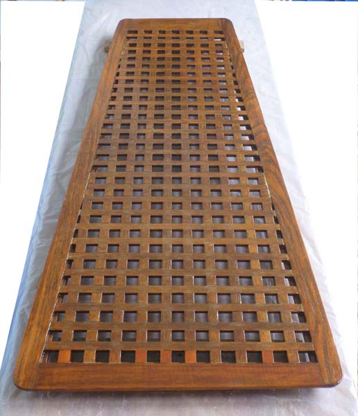

Finished with three coats of Cetol, it doesn’t look bad from a distance.
