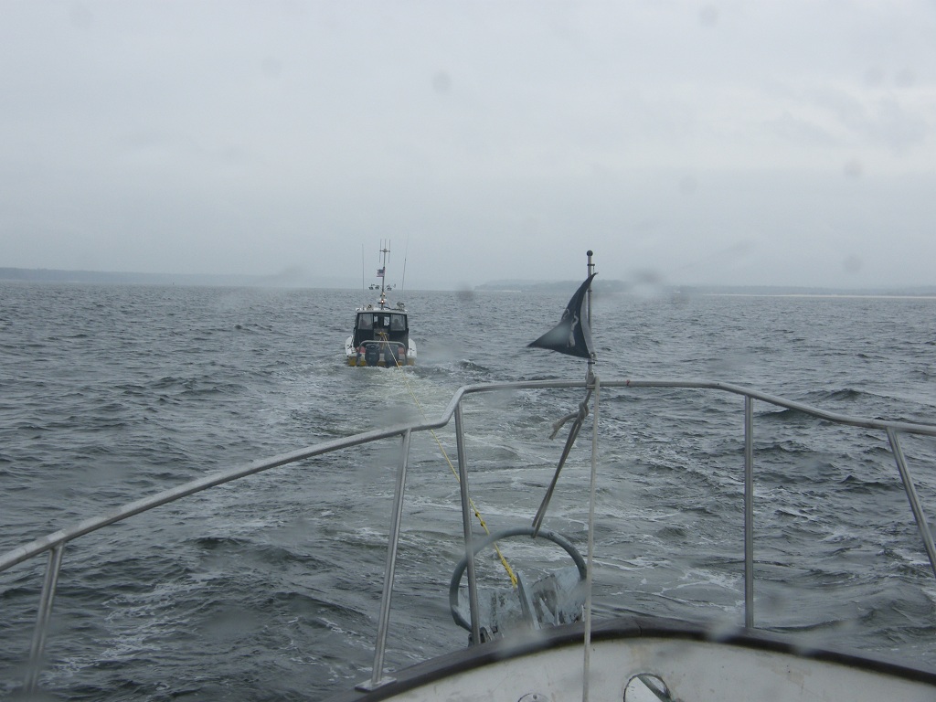

I posted this pic to our blog from the middle of LI Sound. Our Verizon hot spot is awesome.
