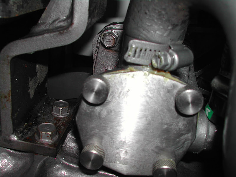

What model Yanmar do you have? Mine is a 2003 4JH3E. The engine is installed under the galley. It has the raw water pump facing aft, below the alternator. A very poor design indeed. I have limited access to the pump through a small access panel, and I can just reach the pump. Other people seem to remove the alternator every time they need access to the pump. I don't . Impeller replacement became much easier since I replaced the cover with a Speed Seal. When the boat was built I ordered an after market engine mount bracket, as the original Yanmar design would not allow removal of the pump without removing one of the engine mount brackets first.
