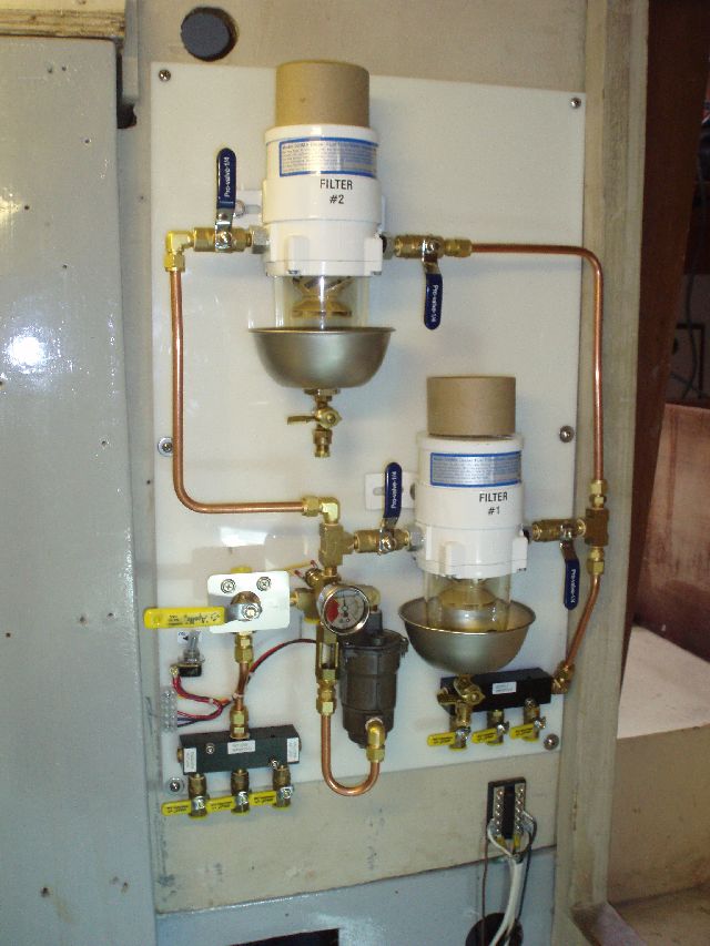

Fuel filter question
Yes on the ease of changing filters
I agree with Max ...
Or have the great folks at KTI Systems...
Let me just say that I have only needed the second
I'm amazed you've lived with a spin-on for as long as you have, I HATE those damn things... (grin)
Jon, where you going this winter??
We have (an early model) of that unit.
Be sure to get the correct fittings for the Racor
Yes you can build your own fuel manifold...
The heat shield is not "required"
It may not be required by law but...
On my survey....
It was the insurance underwriters...
Heat Shields ABYC Standards
Yes, that is what West Marine posts on their website
I have that setup...
Is the pump with the tranparent lines from the bilge or head/holding tanks?
That is the aft head pump.
At least you didn't use Pyrex! ;^)))
Man, talk about access and a nice layout...
Too easy....
You also need to install LEDs...
hey, that fits right into his motto. GRIN
Neil, I had one Racor 500 and decided to change
Racor
That's funny, I left the part
Thaks everyone for all the comments and
i did it myself. easy.
