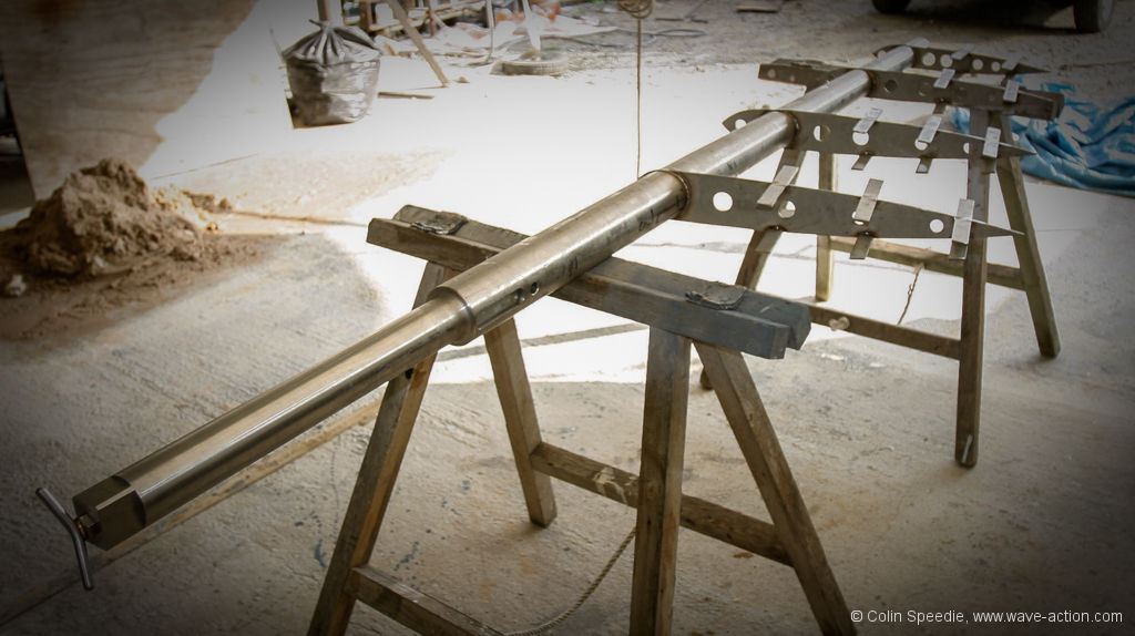

As the typical rudder construction I'm most familiar with involves length of the "rudder shaft" continuing through most of the chord depth of the rudder blade towards the bottom, seems that a bending of the "rudder blade" would likely involve some bending of the shaft inside the rudder...
Now, I suppose it's possible that the rudder shaft ends very close to the top of the rudder, and is attached to some sort of internal "frame" at that point... If that were the case, seems an incredibly piss-poor method of spade rudder design and construction, to me...
Seems to me the way to go for a rudder on an offshore boat, is to extend the shaft through the full depth of the rudder, no?
